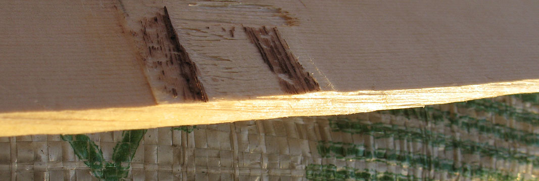

Is this a rather serious runout or what.
Pictured, the top of my first guitar. It didn't have much volume, and it wasn't getting any better after i thinned it on and on. I removed the back and put stronger braces and that didn't help either. In the end I decided to remove the top, and split it to check the thickness. (except bridge footprint and edges, mostly 2mm and under)
The picture isnt that good but I think it can be easily seen that the fibers are only 1 inch long.

that is rather extreme runout and unless it was expressly sold as low grade wood i would be letting the vendoe feel my displeasure.
that being said i don't think that would on its own account for your volume problems.

Alex, I think all you have to do is send your vendor the picture you posted above. I can't believe that anyone could defend that wood as AAA--that's some SERIOUSLY short grain! You're right, mistakes can happen, and that board might have been sorted on a Friday at 4:30pm. Contact them and see what they say.

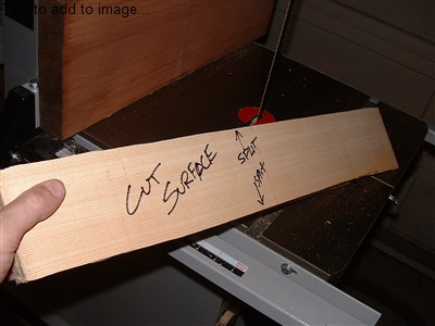

So I must not be able to see as clearly as everyone else. If I am understanding correctly. You split(I am assuming did not sawn it) the top lengthwise and you are showing the side grain runnout? Or have you split the top with the face to determine face runnout? Is the visable grain reasonably straight? Is the soundboard closely quartered at least at the ends?
I am really trying to fully understand since there is talk of a dealers reputation.
I know I saw my sets from split Bolts generally(unless I buy a billets from a dealer). That allows me to control my grain(at least get it as close as possible, you still have to saw though, and I have never run across a dead straight split bolt). I have always assumed most dealers do the same.
I have done a lot of testing on different woods for stiffness(with the grain and cross grain), but still for the life do not feel I have a good handle on grading. How people are able to grade even ruff sawn(3/16" thick, non surfaced) is beyond me. Of course I have only made a few hundred sets. Maybe when I have made thousands I will become more confident.
Peace,Rich

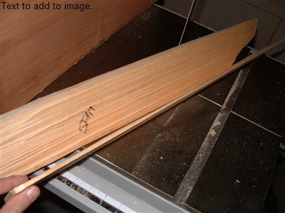

This picture is of a bit of wood left over from cutting soundboards. I split the sides and to show face runnout.
I try to make cuts as parallel to the split face as I can. Of course I have never seen a billet or bolt split so straight that you could run a straight edge on it over 26 inches.
That aside, I am still curious about the picture above, because it looks like a split showing side grain, but not face(unless I am just mistaken. Which is very possible ).
Peaec,Rich

Yes the drawings in the thread show the issue quite well. The only difference is that in my image the fibers rise and exit the board from right to left and in the drawing from left to right.
